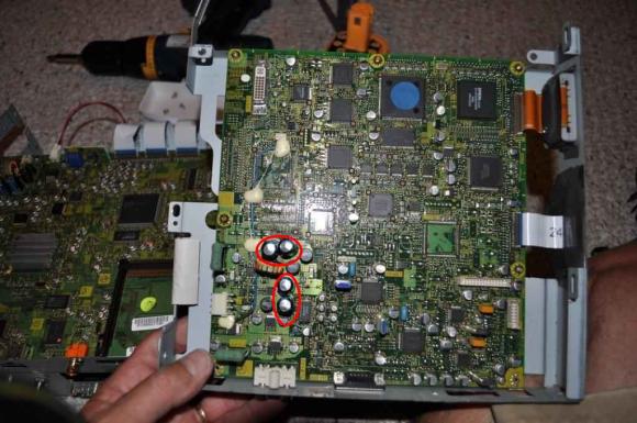

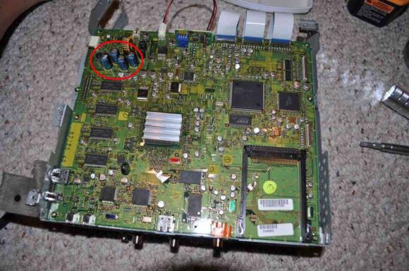

OK, I've had the blinking green light problem. I took the set apart, pulled the chassis & brought down to the workshop. I removed the DM board and replaced the 4 bad capacitors, which were bulged out at the top. I used hi temp 35 volt 1000uf 105c replacements. When I had the board apart, I noticed a few of the caps on the power supply board & one of the other boards had a few capacitors that appeared to be bad (bulging tops). Since I only had the 4 replacements, and I didn'twant to forget how everything went back together, I re-assembled the tv. I plugged it in & everything worked great for a week. Today we had a power failure in our area, and when the power came back on, I have the blinking green light again. My questions are; If I replace the remaining bad capacitors on the other boards, will this correct the blinking light problem. And, do I substitute the same 1000uf 35volt 105c capacitors like I did on the DM board??.

I had the same problem with my 3.5 yr old set.I took it apart following instructions (V26 Chassis Replacement) in an earlier link in this thread. I think you can find it here too (http://www.pdfoo.com/mitsubishi/193-2311-pdf.html). Note there are lots of screws and connectors so be careful and organize screws.I wasn’t and have 2 screws left J. I replaced the caps with Panasonic caps from digikey.A package of ten cost $3.54 but $40 for shipping because I had them shipped overnight. I did check radio shack first but they didn't have them.
After I replace the caps and put the whole thing back together I went to turn it on and noticed an amber flashing light on the front of the TV and thought, crap - all this for nothing. I then realized I forgot to put the air filter cover back on which has an interlock on it that prevents the TV from going on. After I put this on the TV worked.
$40 investment and a couple of hours is better than ~$1000 to have it fixed or buy another.
