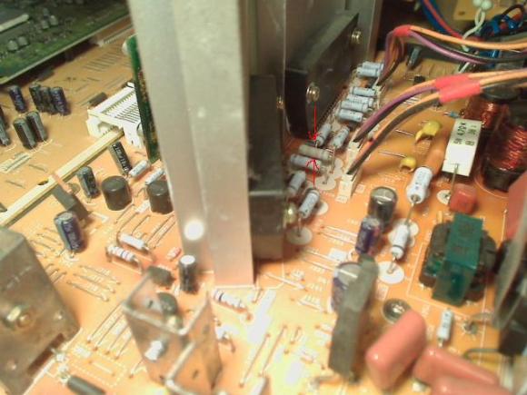

Would this classify as a burned resistor. My tv would not turn on. The led on the front kept blinking 3 times. I removed the back and looked at the resistors, noticed that this one was considerable darker than the others. Does this look like a burned resistor to anyone?
Help please....

Turn off the room lights, & see if it glows when you turn on the power.
Otherwise, you may need to remove one leg, & test it with an ohm meter.
