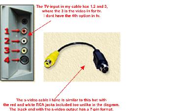

April 12, 2006 2:55 AM
Hi Matt, I am attaching a copy of the s-video cable and the tv inpput inlets i have.Pls lemme know whether i'm using the right ones. The cables are brand new ones but still i will try changing it this weekend and let u know the result on monday,So before that i would like to confirm about the right cables. By that time i will be updating all the drivers for my comp including the Graphics/video drivers as u mentioned last time. Yes i bought both my comp and tv from india, but my comp is manufactured in korea or some south east asian country by HP/COMPAQ.
April 12, 2006 11:05 AM
Make sure you only have one video source plugged into your input at a time. It sounds like the cable you're using to connect the laptop to the TV breaks the 7-pin jack into a composite (yellow) red, and white audio. If you happen to have an S-video connector plugged into the adjacent input, the TV will ignore the composite input. Use only composite OR S-video, not both at the same time.
Check that and post back after you update any drivers.

The good news is i succeeded in my mission.The fault in my case turned out to be a non-standard cable. My video jack(yellow) and Audio(red) was interchanged. Technically after my market research it seems that out of say all laptop makers no one follows a particular standard for the audio and video port locations in the 7-pin config, so the interchange which i overlooked.
